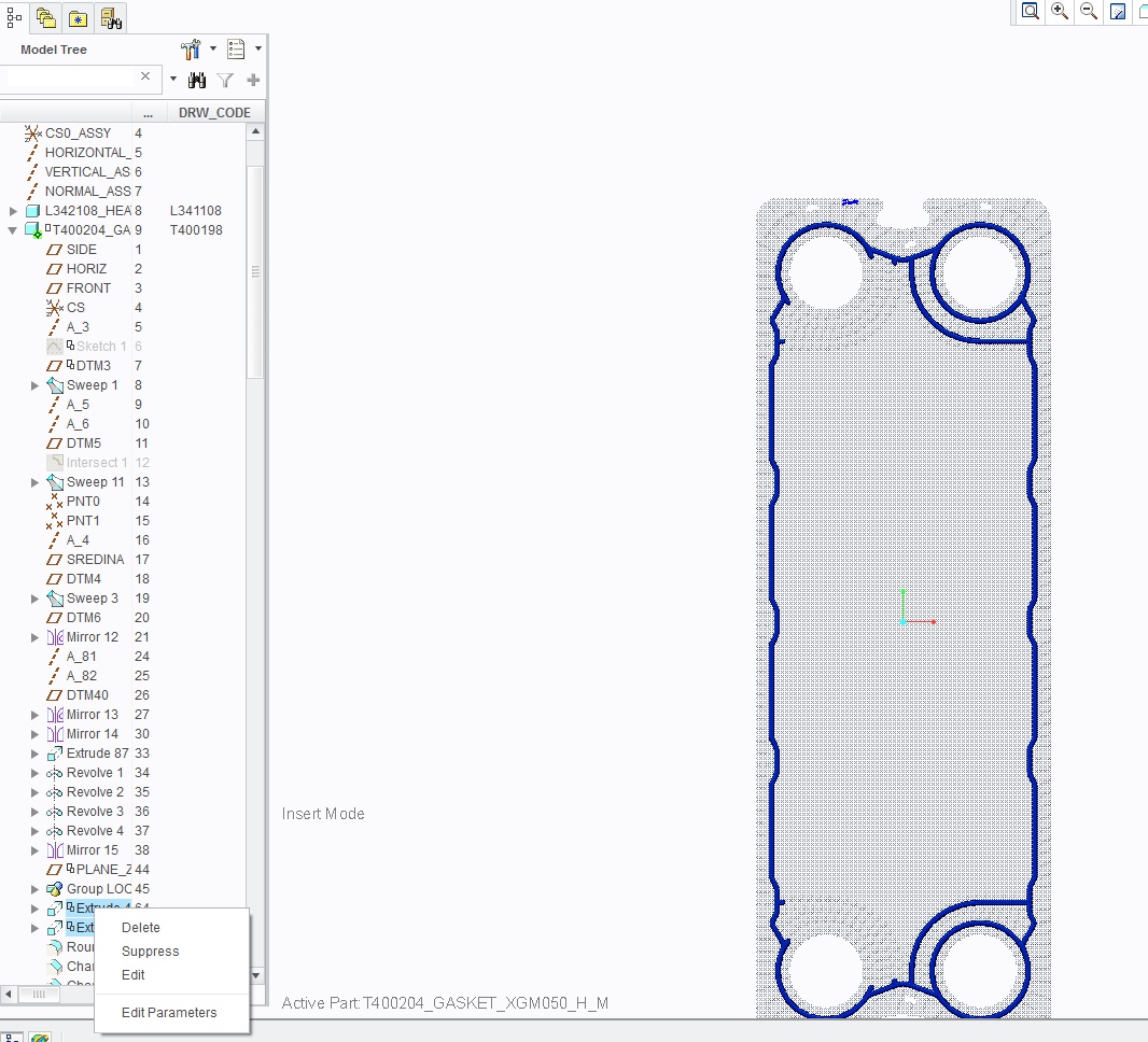

some features can't be grouped (attached file), does anyone know why?
Regards, Saša
    6 replies
    Apr 15, 2014 11:47 AM UTC
    yes it is in assembly (some features have correlation with the other part). I can't group also Extrude 4 in 5.
    Apr 15, 2014 1:56 PM UTC
    I performed the save as but still I can not do the group operation. Do you think because the part is modeled in context (has references to the other part in assembly).
    Regards, Saša
    2-Explorer
    Apr 15, 2014 1:25 PM UTC
    Group failures are sometimes due to references that are part of features that are not in the group. For example, external sketches can interfere.
    The best method of determining this is to select items, such as the rounds, that will group, group them, and then try to drag other features into the group. I recall this gives more diagnostic information about why it won't group - such as "Can't group X without Y"

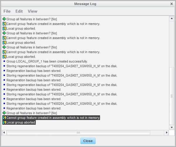

    Apr 16, 2014 7:41 AM UTC
    grouped part of features and then tried to add the remaining features and I've got the below message.
    Regards, Saša
    Apr 16, 2014 7:48 AM UTC
    Try to open the main assembly and then activate the part, then try to group these feature.
