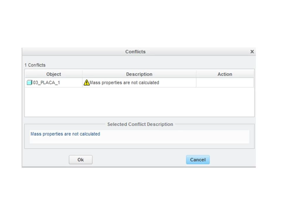

Hello, I would like to know how to disable the screen that appears in Creo 1.0, which was not created mass "conflicts" (mass properties are not calculated) next image in question has a solution or not.grateful. ........

André,
open that part and compute its mass properties (Analysis > Mass Properties).

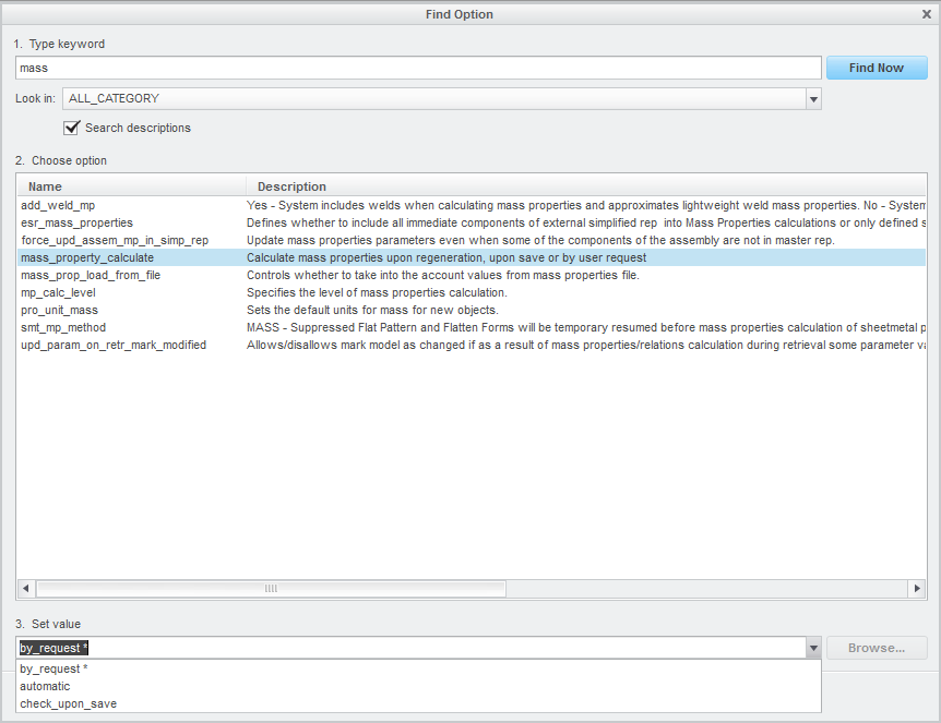

You can do what Martin said or change option in config.pro
