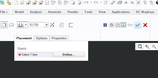

    The "Sketch" tab does not come up initially. Once you click "Extrude", you need to select the placement tab on the dashboard:
    From there you either select an existing sketch or click "Define" to create a new one.
