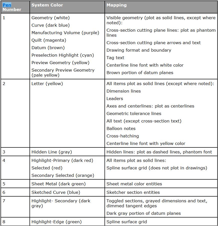

On the bright side, I found this... a color map for the classic interface when looking for pen table information. This one never even got updated to WF!
This is, after all, a critical UI component of the platform. How could this ever pass quality protocols.
