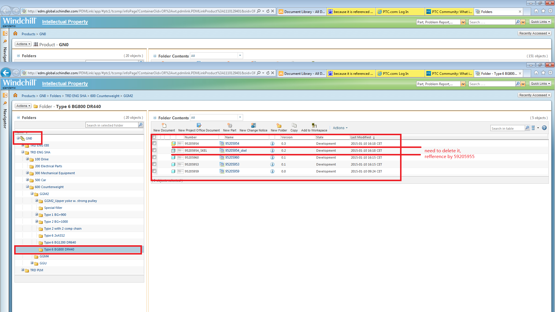

how to delete the objects located in different folders in windchill? the objects are referenced by each other.

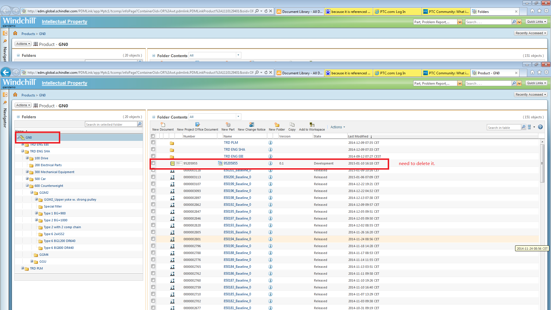

GN0----95205955-->need to delete
GN0----Tpye6 BG800 DR4400--------95205954 and other objects--->need to delete

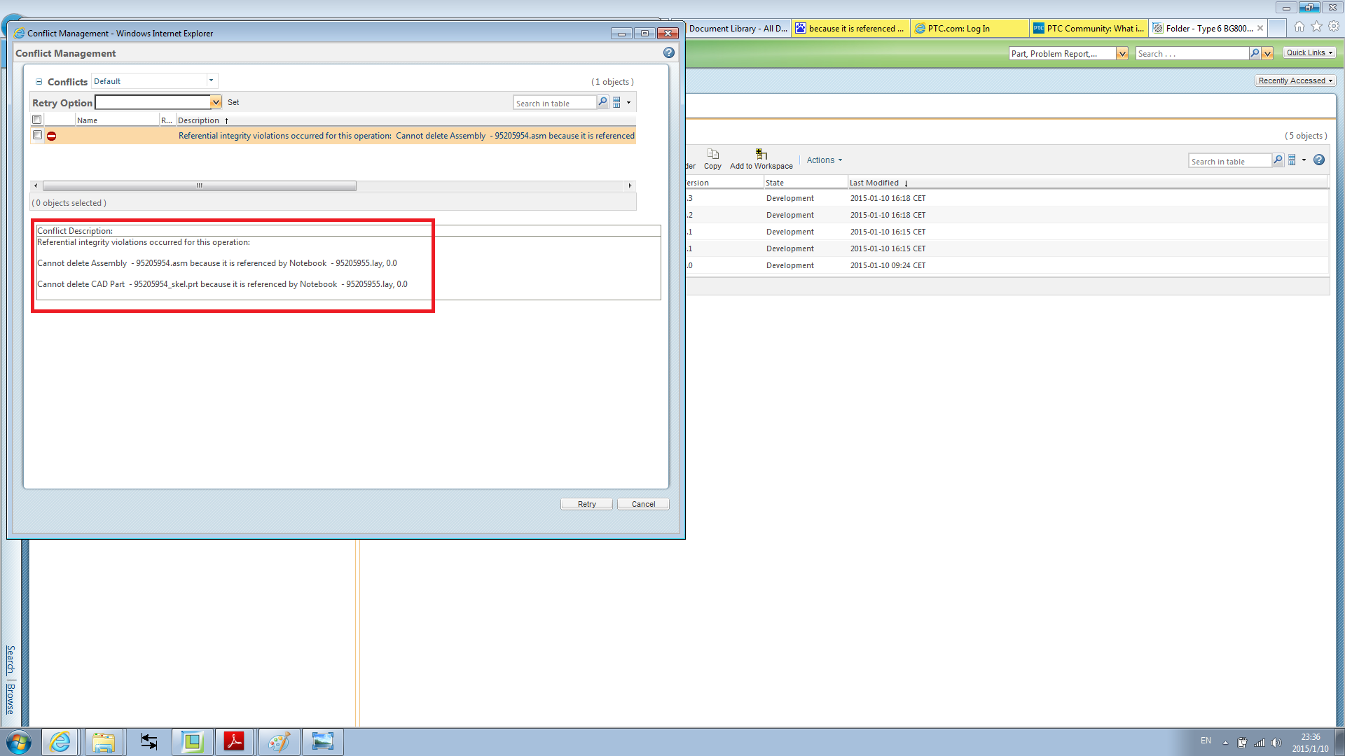

95205955 referenced by 95205954,95205954_skel
showed in followed printsreen:

That will not be easy.
Windchill references prevent you from deleting referenced files.
You can try by starting with any drawings that may reference your parts. Delete them.
Also delete any baselines that may exist.
Then you can try to delete any assemblies and finally the detail parts.
