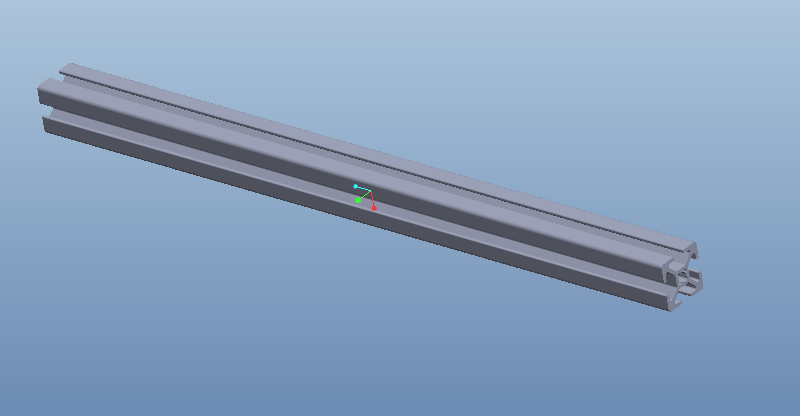

I downloaded an 80/20 CAD Model off of 3d Content Central, however it's too short. I need it to be 17.5"s instead of a measly 12. Is there anyway to extrude or stretch the model to fit my wishes?

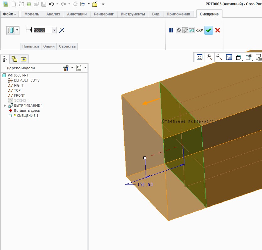

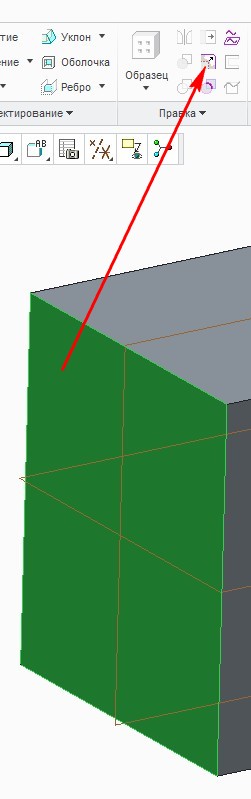

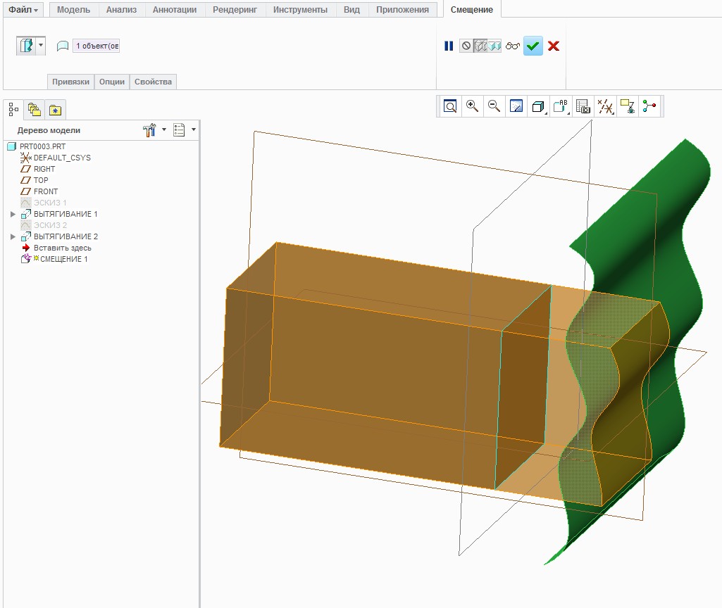

    You can also offset an end face of the model.
    Some of the options of this command are really powerful and useful.
    Look at the option which is called Exchange Surface Element for example.
