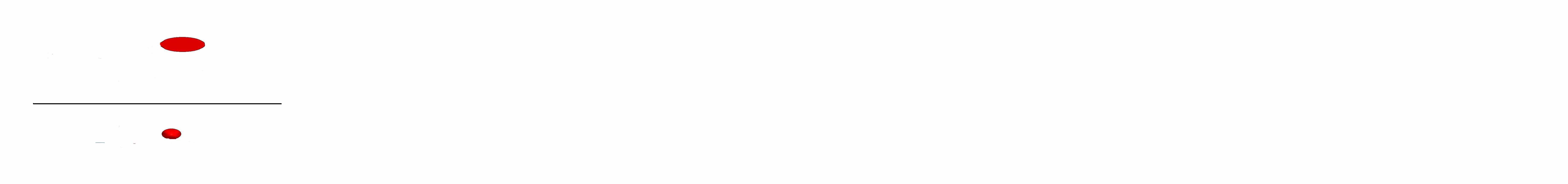

I need to make an egg in Wildfire. The only difference is that the egg shape would be somewhat of a sqaushed shape. Not perfectetly round.
I have attached a jpeg that shows a side view and end view of what I am trying to produce. Any turorials or suggestions would be greatly appreciated. My client is waiting for me to finish.

    Start with a sphere and use the Warp feature to stretch/push the sphere
    into the shape you want. See the attached.
