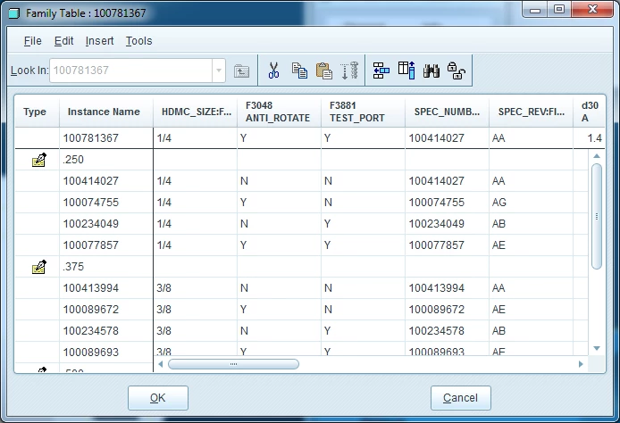

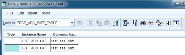

    I've been using Family Table UDF's for several years and I would say there's not much difference between the UDF Family Tables and other Family Tables, except one thing that irritates me. It is that you can't verify any of the instances. For some reason PTC has removed the Verify button in the family table. To work around this what I do is take a copy of my entire UDF Family Table and paste it into a Family Table in the Reference Model of the UDF and then run the verify there. Other than that alls the same.
    Normal Family Table:
    [cid:image001.png@01CBB649.2EB12420][cid:image002.png@01CBB649.2EB12420]
    UDF Family Table:
    [cid:image003.png@01CBB649.2EB12420]
