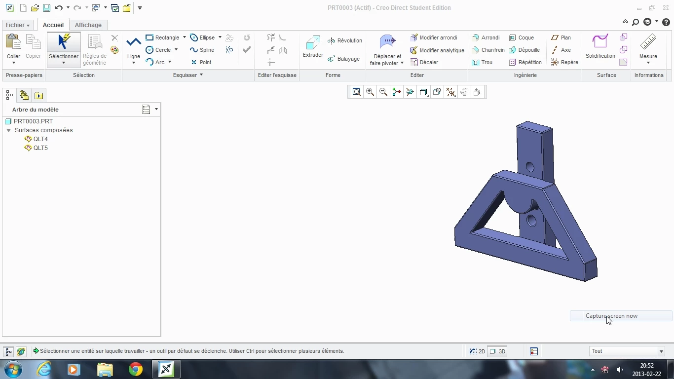

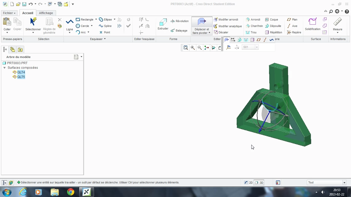

Hi all, I'm trying the new version of Creo Direct 2.0 student edition and I have a big problem with copying and pasting. When I want to paste my piece, I cannot move it on the left or the right with an angle of 0. I can only move my «Pasting» into 45 degrees ! Help me please. How can I move objects in an horizontal way ?
Thank you a lot for you help, I really need it now !

    For all the one who has the same problem than me, I found the solution ! You have to press TAB and then, click on one of the sufaces to move it in this direction. After, you release TAB and you could move you piece in the direction you want !!!
    Thank you for your help Antonius

    There should be a way to orient the dragger without moving the paste part. Once you orient the dragger, it will move in the direction you want.
    Feb 23, 2013 4:30 AM UTC
    It's why I'm posting this question, I don't find how to orient the dragger
    Feb 23, 2013 4:42 AM UTC
    Ohhhhhh Have you tried using the Alt or Ctrl... or even Shift in various combinations to "release" the model?
    I don't have the full version of modeler so I can't look it up.
    Feb 23, 2013 5:43 AM UTC
    I know that with Element direct express, we just have to press shift, and the job is done, but in Creo 2.0 commands are not the same ! I have to do it in Creo 2.0 because I want that make my project move, and I can only do it with paramemetric. But , thank you for your help, I will try to watch some tutorials about it !
    Feb 23, 2013 7:12 PM UTC
    Tab? Okay, I wouldn't have guessed that
