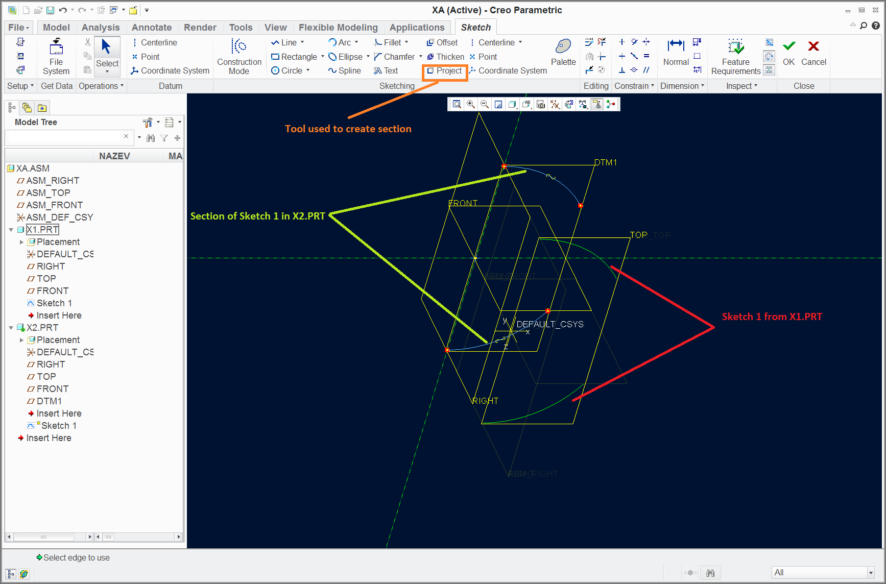

Hello i need help with an easy task. I should do an curve witch i think exist of three arcs, but it should be done Exactly like in the first Picture(same symbols, same numbers and so on). As u can see, ON the two arcs in the first picture it is an symbol witch looks like a spline, what does it mean and how should I proced to make this like they do in the first pic?

    Bjorn,
    reference geometry can be selected from the same part or from another one in context of assembly. See picture.

    That is a projected curve from an external source.

    Okey, but there is not any curve that I can Project there?
    Sep 15, 2015 2:31 PM UTC
    There were... maybe hidden?
    In a sketch, projected curves can be trimmed or extended.
    The seed curve could be smaller.
