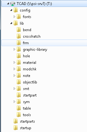

    I have a central server location for all "common" files and startup scripts that are read only
    I let the config.pro options locate those directories.
    makes it easy for administration if there is a change/update
    My setup:
    then I map accordingly

    We handle it very similarly to what Ron is doing.  +1
