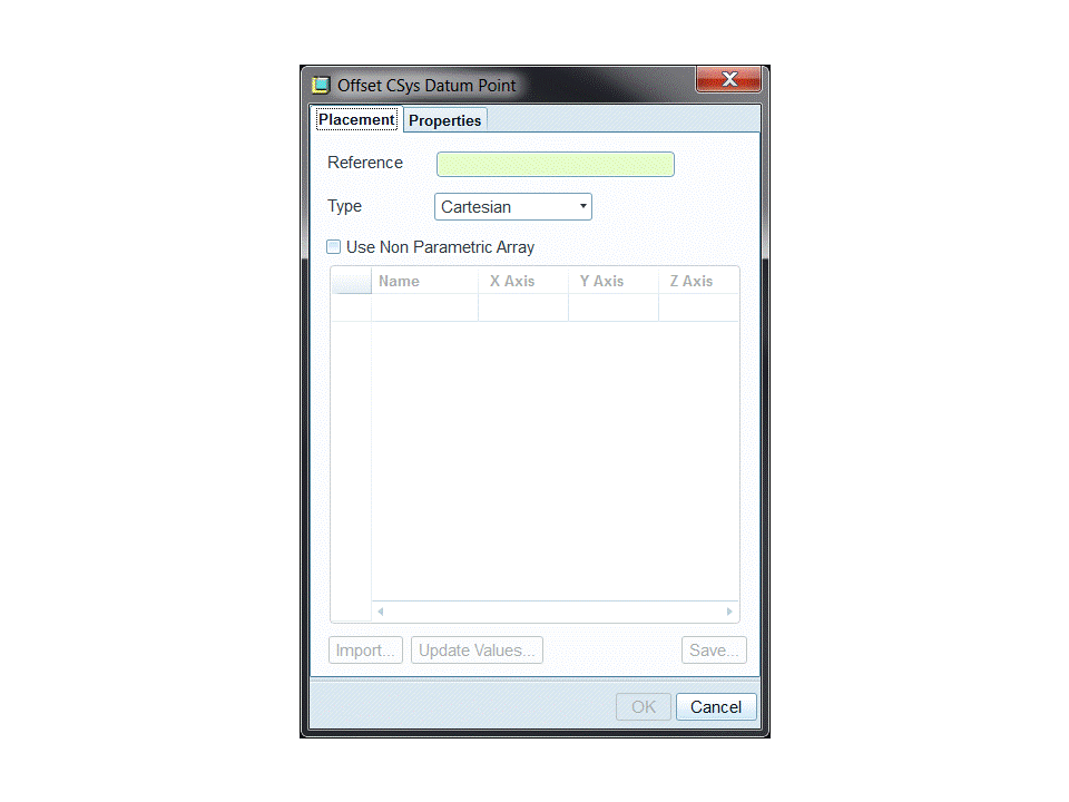

    When I open a new part file and select "Offset CSys Datum points" the import button is grayed out. What am I missing?

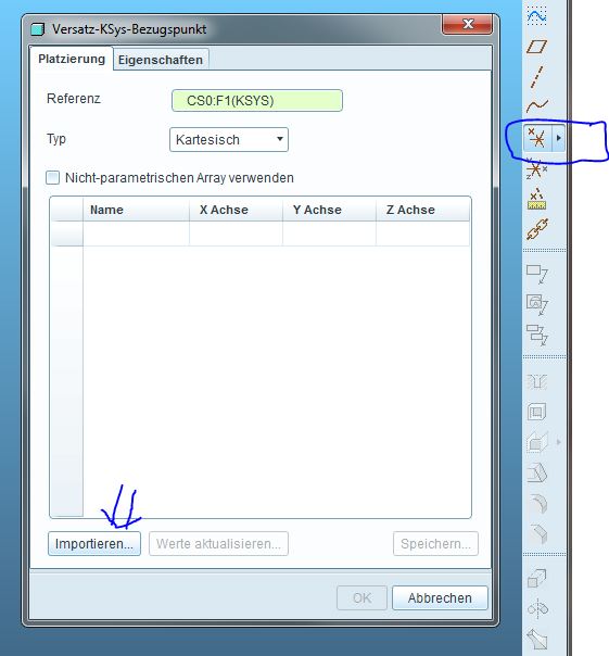

    Dec 11, 2012 1:37 PM UTC
    Hello Mike,
    let see if I can help you.
    In the attachment I put a .pts file that you can see how it is formatted.
    Here a screenshot how to get in Creo (I use Creo Elements/Pro in german)
    Choose Import and then the .pts file.
    That's it.
