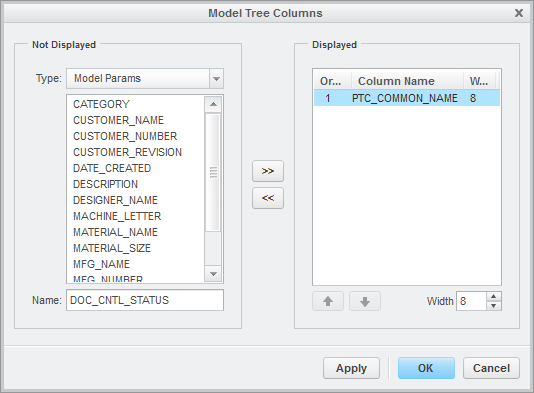

TomU
Apr 15, 2015 2:42 PM UTC
Add a column to the model tree. Choose "Model Params" and type the name of the parameter in.

Apr 16, 2015 6:11 AM UTC
William,
Tom's solution works well. In Part/Assembly mode you can add PTC_COMMON_NAME column into Model Tree and enter the appropriate value into Model Tree cell. Then you must regenerate part/assembly.
Unfortunatelly PTC_COMMON_NAME parameter is not displayed in Parameters dialog box.
