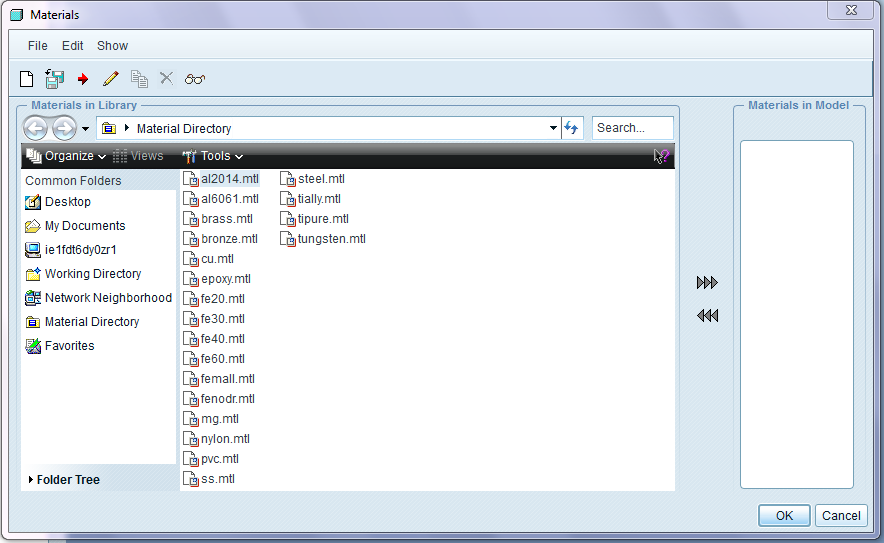

Hi folks,
Can any help us to add new material properties to Material Directory?

    Add new material with "new" icon in top left corner(you can see it in picture you posted).
    Parameters for general materials you can find on wikipedia or if you are adding alloys just google it.
    If you want in options add new location for material library with pro_material_dir and fill that folder with .mtl files.

    You want to know how to add new materials or you want .mtl files?

    Hi Davor
    My question is how to create new .mtl file? if that is not possible then i need .mtl files library.
