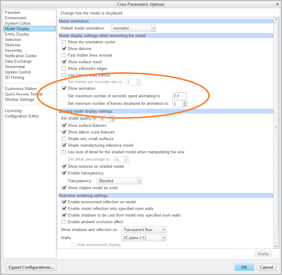

    I think you want to adjust these settings (in config.pro)
    max_animation_time 2.0
    min_animation_steps 3
    If you want to go through the ui, I think the controls are in this menu: (file->options->model display)
