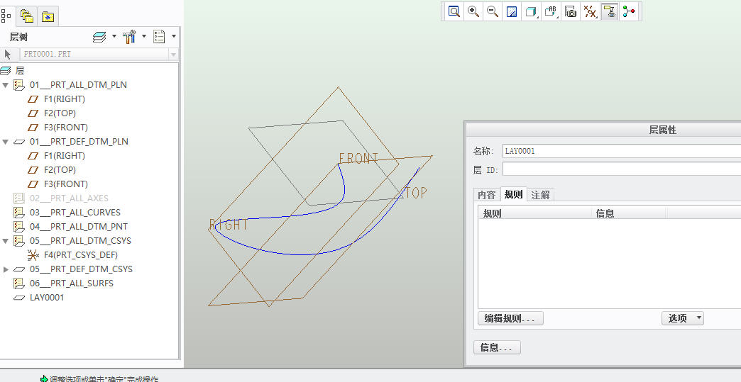

how to automatically place "style curves" on a layer?
I wanna make a template file which can automatically place style curves on a layer .
in the default template file, it can automatically place sketch curves on a layer , coordinate and planes for layers, but cannot set for style curves. why ?
any one could help me . thanks much in advance.

QQ%E5%9B%BE%E7%89%8720140302211812.jpgSee the pic
bduncan17-PeridotAnswer
Mar 2, 2014 1:09 PM UTC

Thanks! That's been bugging me for a while.
