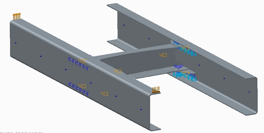

I want to calculate the torsional stiffness of a cross member and compare two different materials. So i put Steel as material and enter the values:

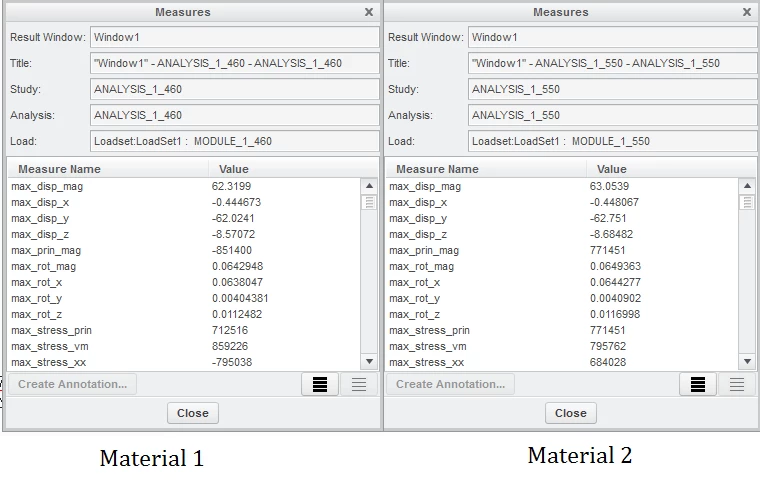

After this, I do two simulations, one for each material. When I later open the Measures dialog box it shows that the "max_rot_x" is the same on both crossmembers (the rotation is in x-direction). This doesn't make any sense to me. The cross member with the better material quality should have a higher torsional stiffness than the exact same cross member with less quality, right?
Is there any other way to calculate the torsional stiffness?
See the pictures below

    Daniel,
    Similarly to the reply to your other thread, the yield stress and UTS of the material do not affect its behaviour in the linear, elastic region - i.e., assuming that the load does not begin to fail the material.
    These values only affect the maximum load that can be applied before the material begins to fail.
    Only Young's Modulus will have a significant effect on the structure's stiffness.
