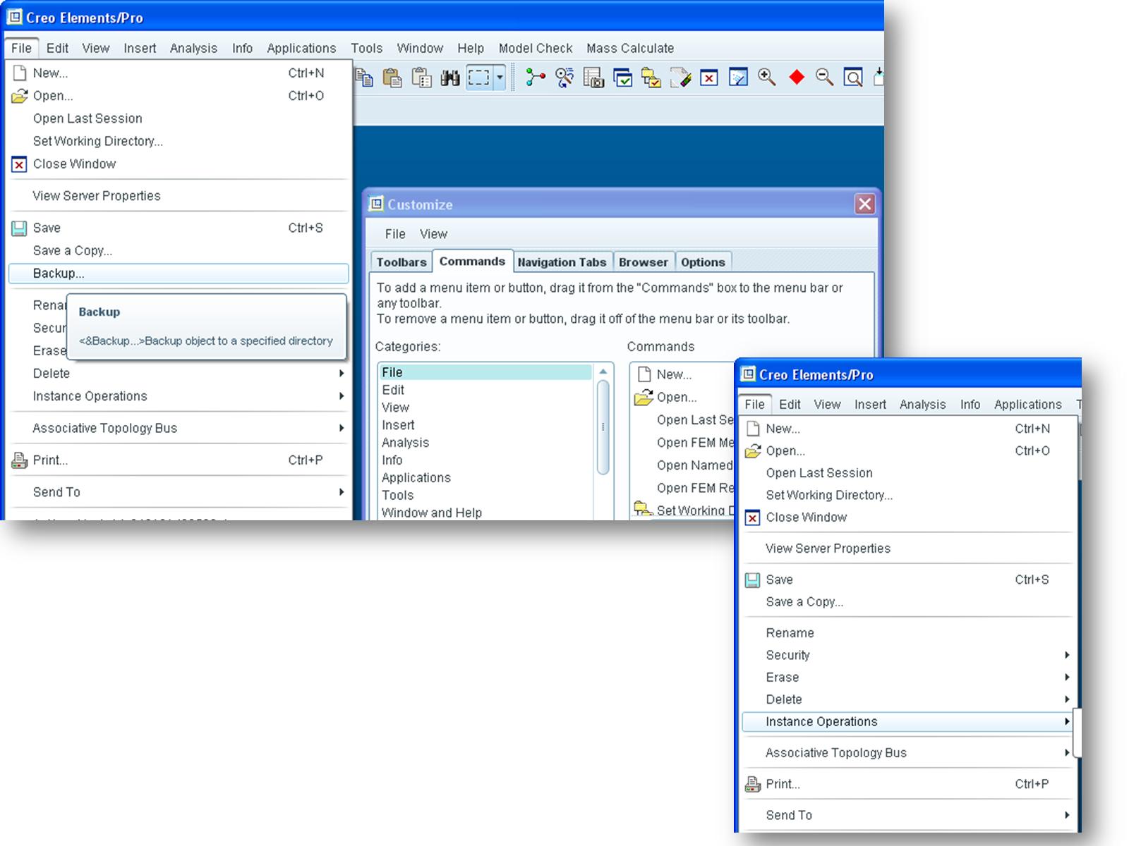

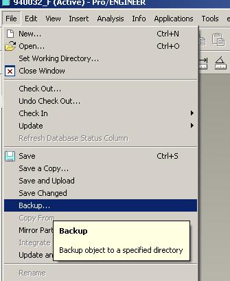

    jinkaiwen1-VisitorAuthor
    Feb 13, 2012 12:57 AM UTC
    Hi
    We can save all the file to another place by used backup fuction, I want to know how to shielding it now.backup.JPG
    Feb 13, 2012 6:48 AM UTC
    Hi
    Go to
    Tools>Customize Screen
    Click file
    Drag Backup and drop it in the screen
    Save the Configuration in proper config.win
    Now the Backup option will be not available in your file dropdown
    I hope this will resolve your problem
