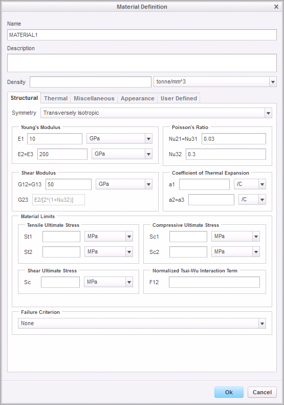

When specifying a transversely isotropic material on the material definition dialog, the unique direction is the 1 direction and the plane of isotropy is the 2-3 plane.
Figure 1

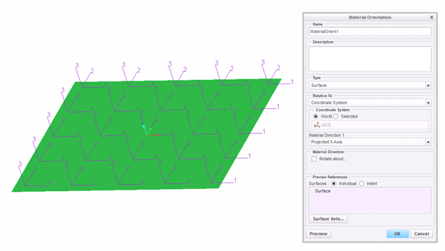

To specify how this material is aligned in your model, you need to define a Material Orientation. The 1, 2, and 3 directions of the material orientation correspond to the 1, 2, and 3 directions of the material. However, for material orientations applied to surfaces, the material orientation 3 direction is always normal to the shell's surface, as shown below.
Figure 2
There's no direct way to make the materials 1 direction to be normal to the shells surface.

Suppose the transversely isotropic material is as show above. The equivalent orthotropic material is
fig3.pngFigure 3
G23 was calculated using the formula,
G23 = E2 / (2 * (1 + nu32))
as shown in figure 1.

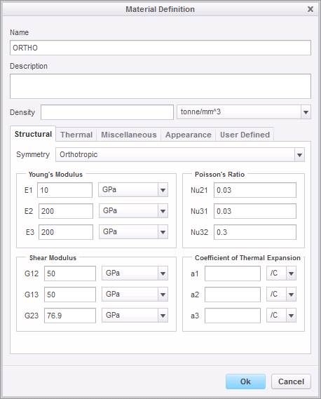

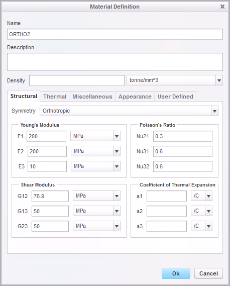

But the unique direction of this material is still the 1-direction and the plane of isotropy is the 2-3 plane. We want to define a material for our shell with the Young's modulus in the normal direction of the shell equal to 10 GPa. Therefore, we need to define a material with E3 = 10 GPa, and with E1 = E2 = 200 GPa.
In other words, we want to swap the 1 and 3 directions for our material. Calling the old directions 1/2/3 and the new directions 1'/2'/3', we want to perform the swap:
1 -> 3' 3 -> 1' 2 -> 2'
E1' = E3 = 200
E2' = E2 = 200
E3' = E1 = 10
G1'2' = G32 = G23 = 76.9
G1'3' = G31 = G13 = 50
G2'3' = G21 = G12 = 50
nu2'1' = nu23 = nu32 * E3 / E2 = 0.3
nu3'1' = nu13 = nu31 * E3 / E1 = 0.6
nu3'2' = nu12 = nu21 * E2 / E1 = 0.6
where I used the relations:
G_ij = G_ji
and
nu_ij = nu_ji * Ej / Ei
(Creo Simulate use's Tsai definition of Poisson's ratio.)
So the material definition dialog is
Figure 4
