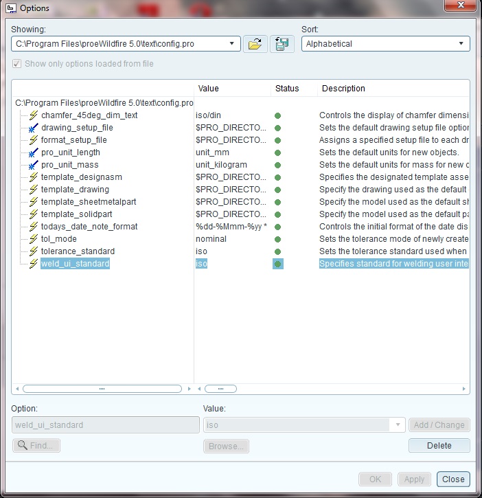

how to create a new pen_table_file
can u pls explain, how to create a new pen_table_file and edit to various pen values you mentoned above.. i can't able to create that..
i followed the steps Tools- options,my window looks like below
but i can't found pen_table_file on that window, pls guide me how to move further to create a new pen_table_file and edit the values..4.jpg

    Hello, try following:
    1) Copy following text into *.txt file. It´s in czech leanguage. Rows with ! are notes.
    ! TABULKA PER - černý tisk
    ! VÝRAZY V KULATÝCH ZÁVORKÁCH - SKUPINY S BARVAMI (NAPŘ. ZMĚNA BARVY SKICOVANÉ ENTITY VE VÝKRESE)
    !(GEOMETRY, VOLUME) hrany geometrie, objem
    pen 1 color 0 0 0; thickness 0.025 cm;
    !(LETTER) kóty
    pen 2 color 0 0 0; thickness 0.01 cm;
    !(HIDDEN) skryté hrany
    pen 3 color 0 0 0; thickness 0.01 cm;
    !(HIGHLITE) červená strana roviny, zvýraznění
    pen 4 color 0 0 0; thickness 0.01 cm;
    ! "Sheetmetal"
    pen 5 color 0 0 0; thickness 0.01 cm;
    !(SECTION)
    pen 6 color 0 0 0; thickness 0.01 cm;
    !(DIMMED)
    pen 7 color 0 0 0; thickness 0.01 cm;
    !(EDGE_HIGHLITE_COLOR) text
    pen 8 color 0 0 0; thickness 0.01 cm;
    2) Extension of the file you have just created needs to be changed from *.TXT to *.PNT
    3) Add following config.pro options:
    pen_table_file W:\CREO_2_setup\pen_table\pen_table.pnt --- MUST BE EXACT PATH to avoid problems
    pdf_use_pentable yes
    l hope it will works.
    Also try to check integrated ProE help for "Pen table" expresion.
