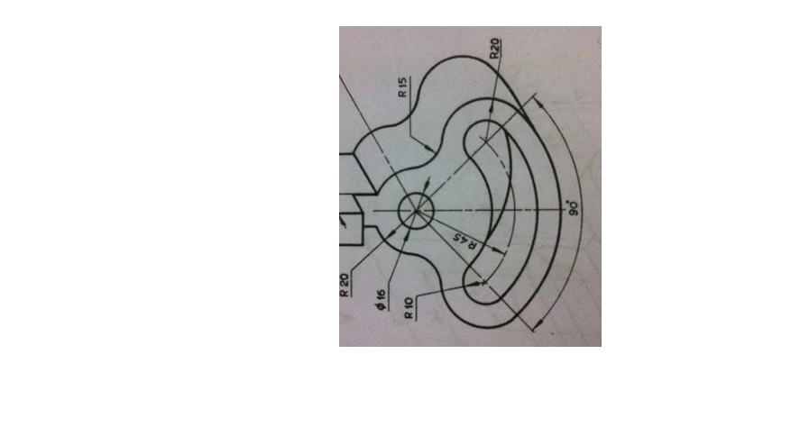

How to create curve profile in proe
Please refer imgae
I am always getting struck whenever i need to create a curve profile like the image attached
Please help me out & request you to create a 3d model and share , it would be better
And teach me the techniques that how to craete this kind of profile in future

    Are you talking about creating the centerline through the curved slot on a drawing, or making the part itself?
    Mahesh_Sharma
    22-Sapphire I
    Apr 10, 2014 12:18 AM UTC
    Haris,
    Would you like to create sketch as displyed in image or part?

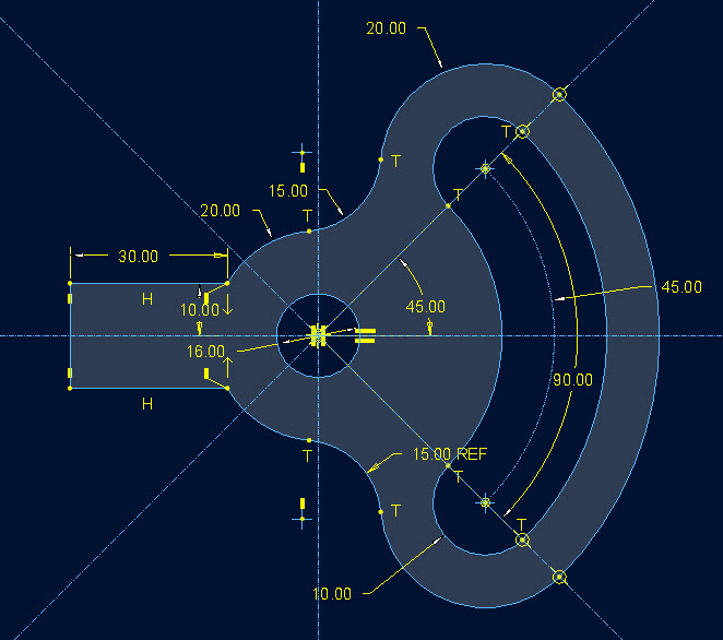

    Part in image can be created by one sketch using Circles (+Trim) or Arcs (depends on individuals).
    Reference part attached.

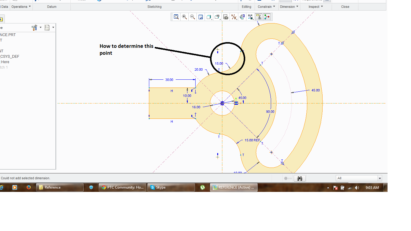

    Apr 10, 2014 3:37 AM UTC
    Thanks for your reply & your answer was helpful
    still I have some doubts that how to determine the point (image attached).
    Apr 10, 2014 4:06 AM UTC
    The beauty about rounds is that they define themselves. That is what the section solver is doing by making the two end of the R15 tangent.
    Some will define parts like this without the round in the sketch and add them as a separate feature. There is no right way, it just depends on independent you like to define your features.
    Apr 10, 2014 9:30 AM UTC
    There are multiple ways of doing it.
    Create circles tangent to each other in sketch.
    Else create a fillet between two circles.
