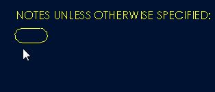

Hi
i need to create ellipse symbol and it is ease, but i discovered that i can not change it, the proportion option do not allowed

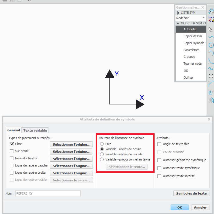

    Hi
    If I have well understood your problem, you must redefine the symbol following the image below. You redefine the symbol then click attributs then you choose the option in the red rectangle. When finished don't forget to save.

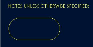

    see pic - i can not change the proportion.

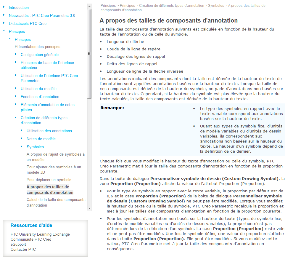

    Mar 17, 2016 12:44 PM UTC
    I have found something in the help center about this, but I have the french version. Here's a snapshot helping to find the location of this help in your language version.
    http://help.ptc.com/creo_hc/creo30_pma_hc/french/index.html#page/pma/fundamentals/fund_eight_sub/about_annotation_component_sizes.html

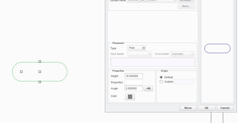

    Mar 18, 2016 11:47 PM UTC
    attached there is an "ellipse" symbol, which allows you to change its proportions.
    Just copy the file in the Creo symbol folder - typically its C:\PTC\creo_standards\symbols\ and add via the "custom symbol" function to your drawing.
    Use offset as the attachment method if you want to link it to a view or a dimension.
    I used Raphaels method to create the symbol and I can change the proportions just fine.
