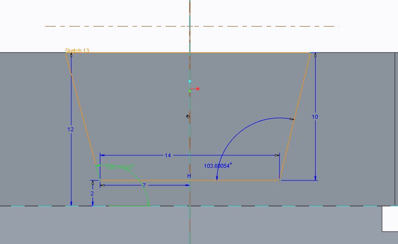

how to define a line dimention
In the attached screen shot, how do I define the upper line with a length instead of using the angels?
I need it to be set to 25mm.
Gil.
    Aug 18, 2016 3:19 PM UTC
    Several options
    1) create another dimension from the centerline to the "point of the angle", this will cause the angle dimension to disappear
    2) you can create a symmetry constraint about the centerline between the endpoint left (-7,2) with the endpoint on the right which will become (7,2) and one dim will have to go away, either the 7 or the 14
    3) make the angled lines have a constraint of equal lengths.
