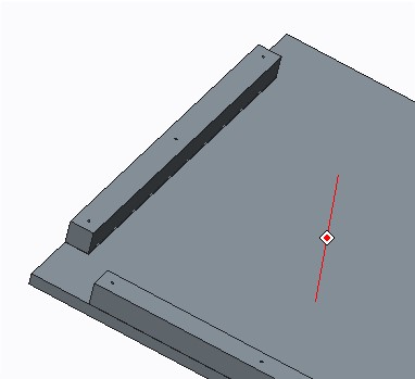

How to disable red line during spin?
How can one disable the short red line that spins around during model rotation? It's quite annoying.

    May 2, 2014 7:31 PM UTC
    In the configuration editor or config.pro set the option below to NO and save your config.pro:
    spin_with_orientation_center

    May 2, 2014 1:07 PM UTC
    Please upload some picture.
