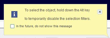

This is driving me crazy. Is there any way to disable the selection filters so I can freely pick what I want, like I used to be able to do before Creo?

    Well it says hold alt.
    Feb 6, 2014 2:26 PM UTC
    Yeah and there is a period at the end of the sentence. Before you get to the period, its says "temporarily".
