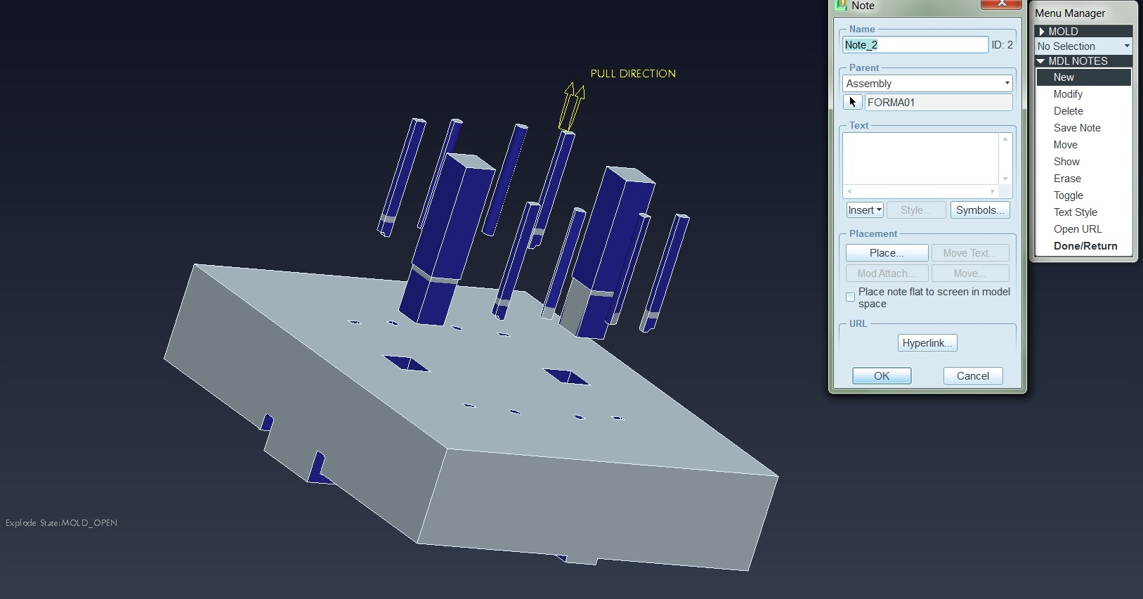

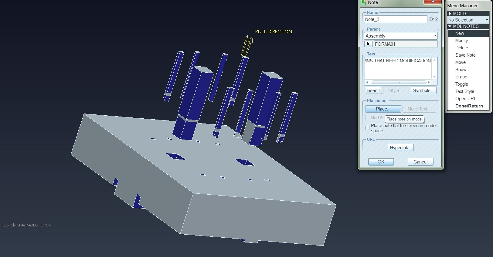

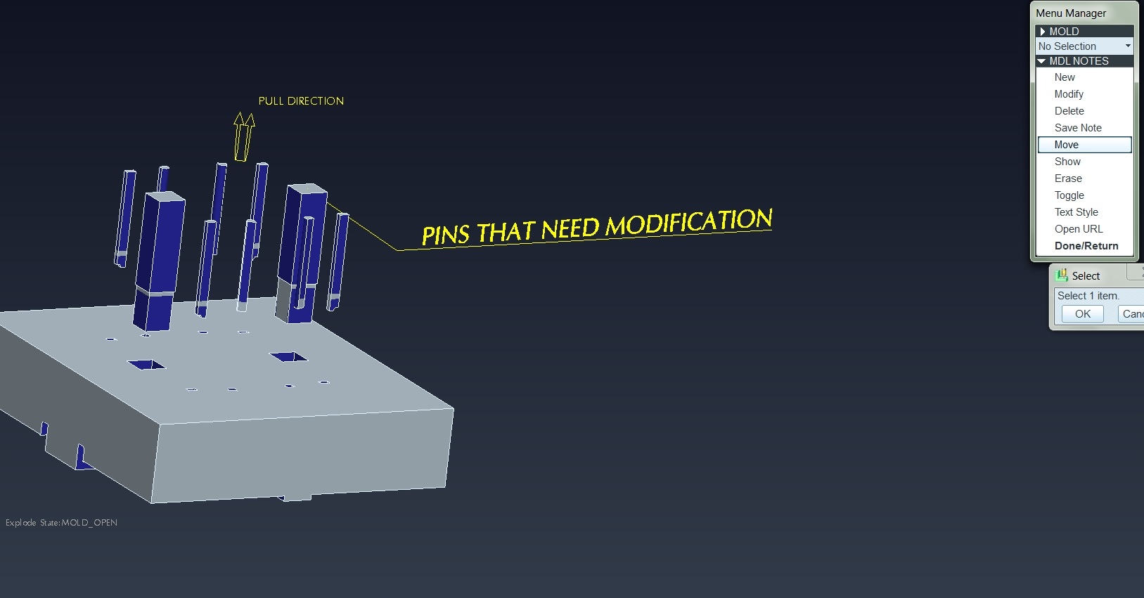

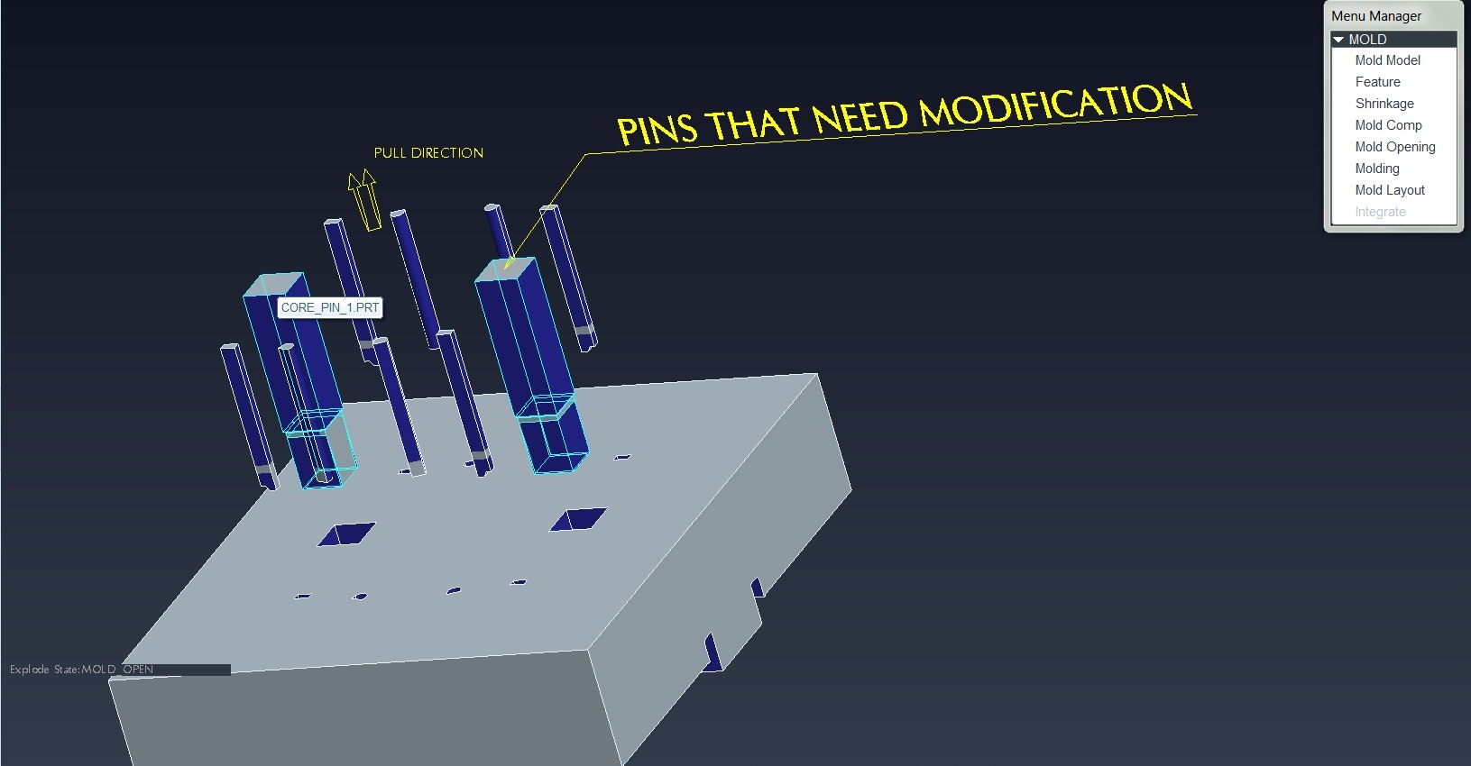

    Feb 8, 2011 1:46 PM UTC

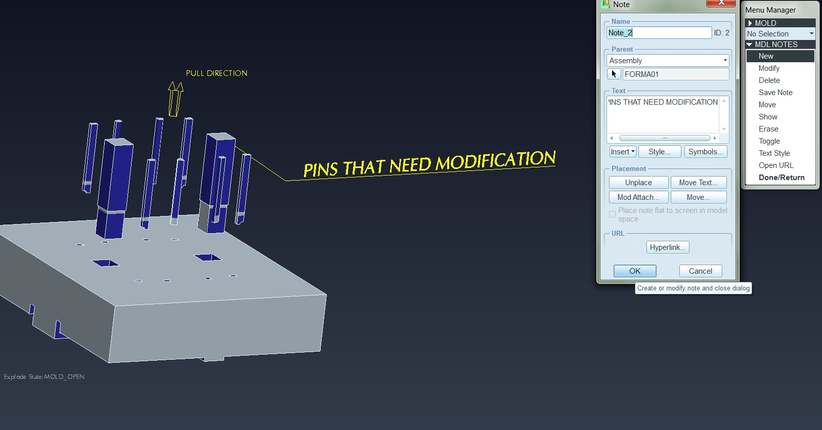

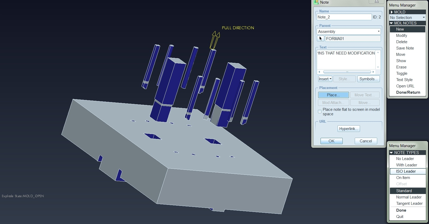

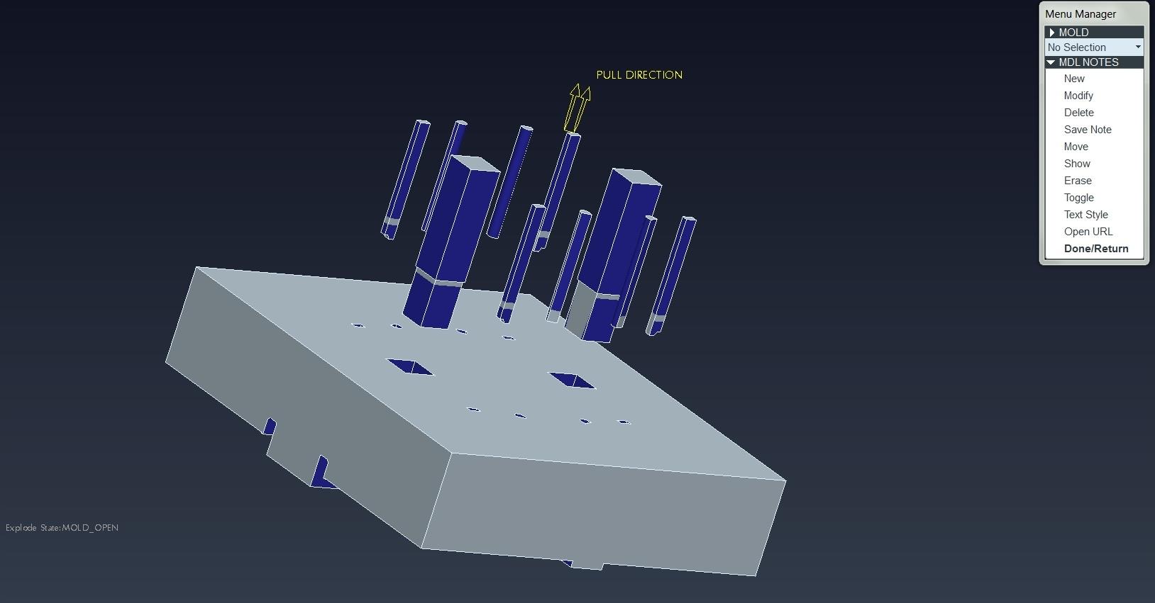

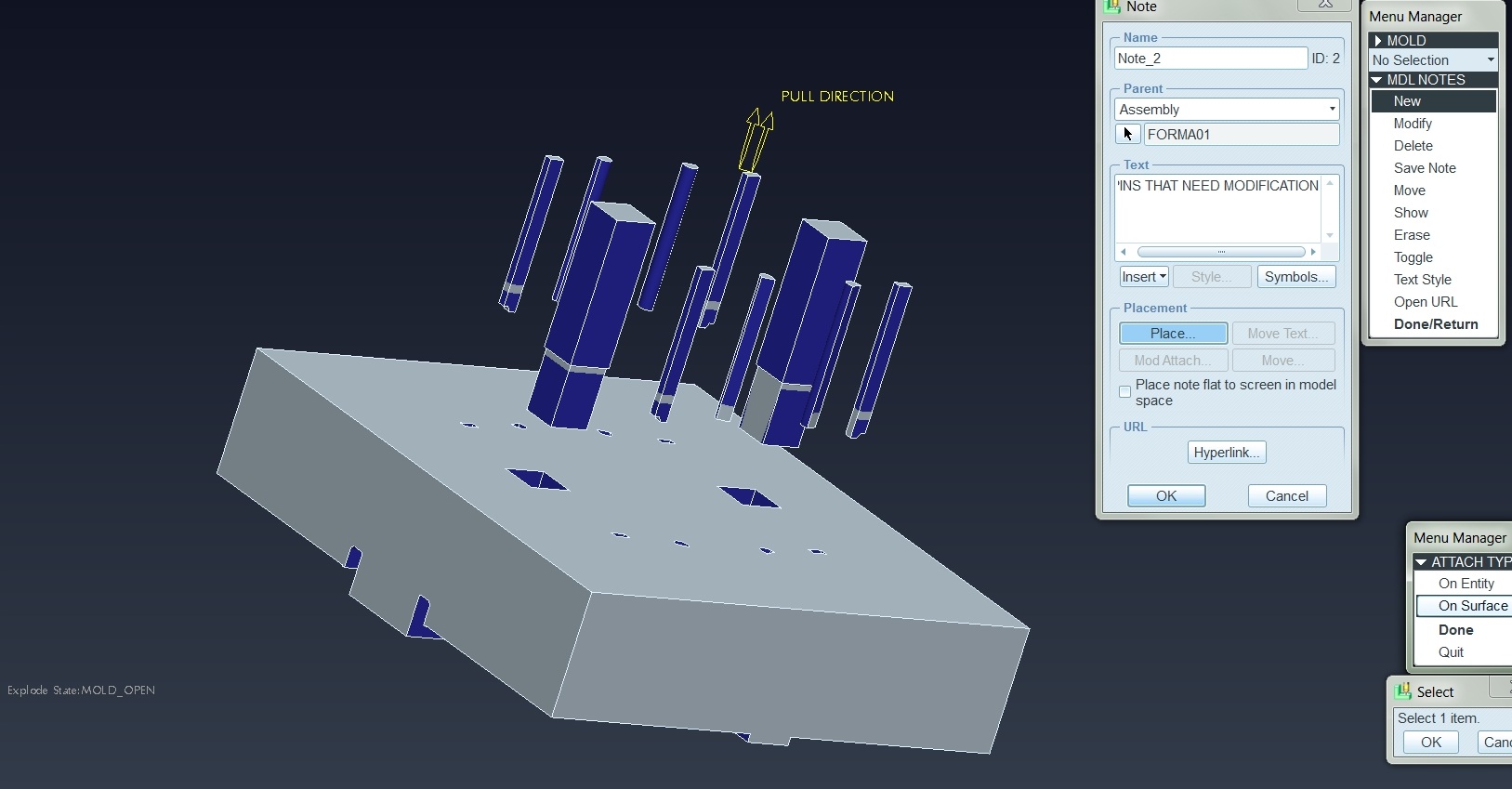

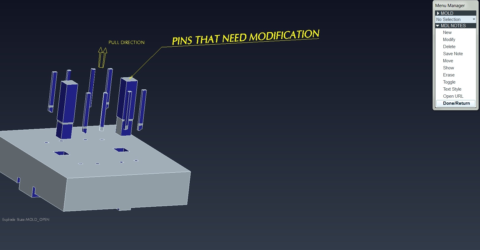

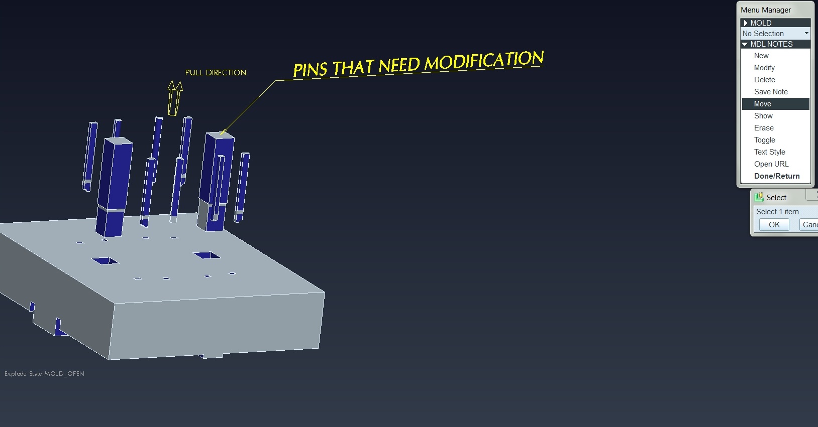

    hi Sylvain,
    I am solving the same problem at the moment.
    You can make notes in assembly mode that act like datums. Theres an icon to show and hide annotation in the same panel with datum planes, points etc. Maybe you can add notes in part mode too, I am not sure.
    I used the same command to create my note: Insert > Annotations > Notes
    Then I did following:
    I am in mold assembly mode creating that note btw

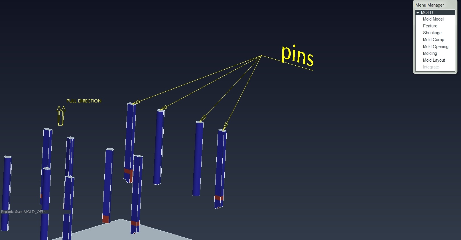

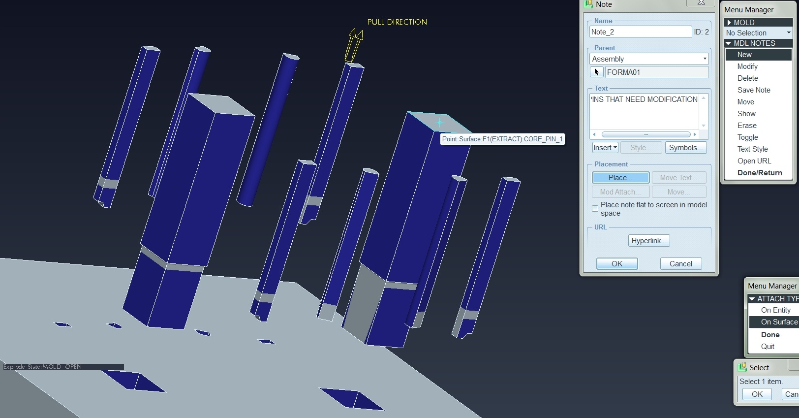

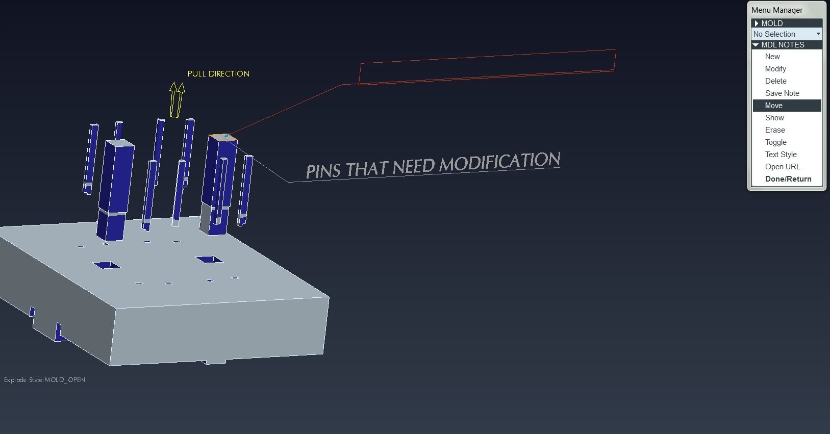

    Note that in thel last picture I am pointing at the same pin on the other side of the assembly which is the exact same pin. Right now I am trying to figure out how to make a note with two leaders to the same note so I can point at that other pin at the same time.
    Feb 8, 2011 5:26 PM UTC
    In your pictures select Mod Attach. If it works like notes in a model there should be an Add Ref selection, select that and hold the CTRL key while making other selections.
    Feb 10, 2011 8:21 AM UTC
    hi Kevin,
    That works great.
    Thanks alot.
