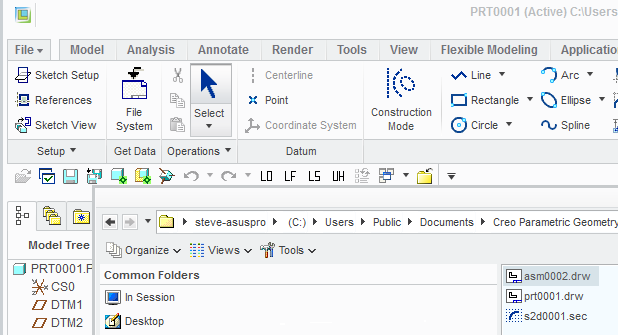

How do you import a sketch (a sec file) into creo parametric 2.0.
    DRFaustAnswer
    Nov 27, 2012 10:09 PM UTC
    Select the "File System" icon then select the desired sec file.

    DRFaust12-AmethystAnswer
