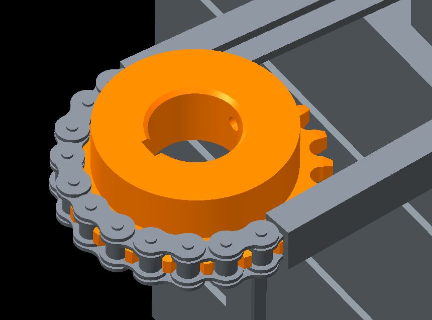

    Check out Boston Gear you can download sprockets and either modify them or give you some input on designing them, I am sure they aren't exactly the same as most bike, but it give you something to look at.
    You can also config and download chain if you don't care about it being parametric on 3D Content Central search for roller chain. That is how I made attached picture.
    Also check out Turbo Squid for various bike models (I have not looked but I bet they are there).

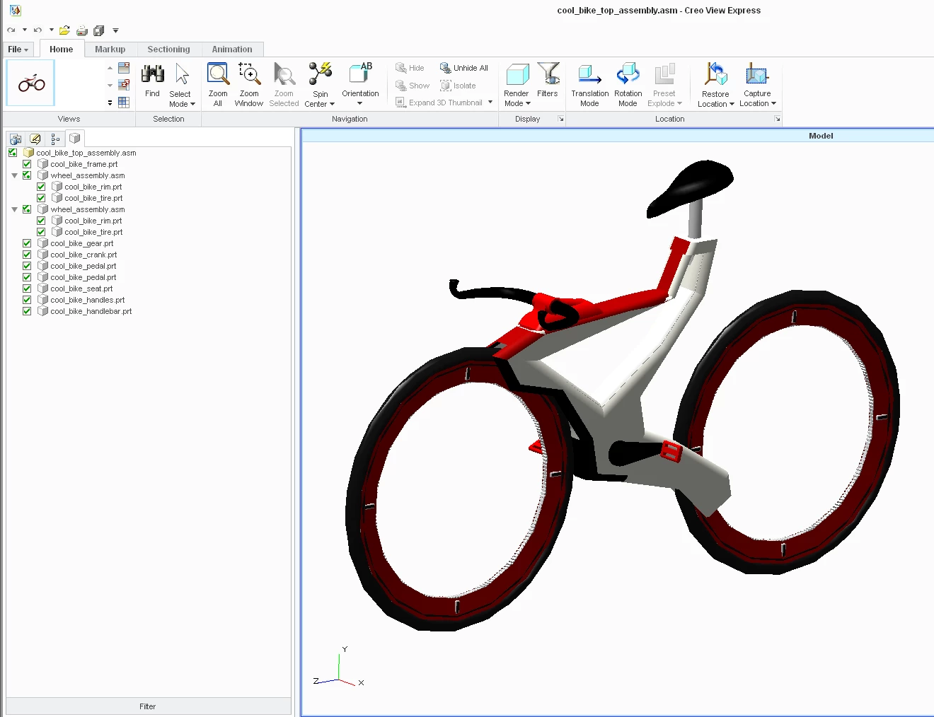

    Oct 31, 2013 9:01 PM UTC
    If anyone is interested, a simple bike, created in Creo can be found at the following link ("How to Model Almost Anything" manual):
    http://www.ptc.com/company/community/schools/projects.htm#creo
    http://www.ptc.com/view?im_dbkey=157747
