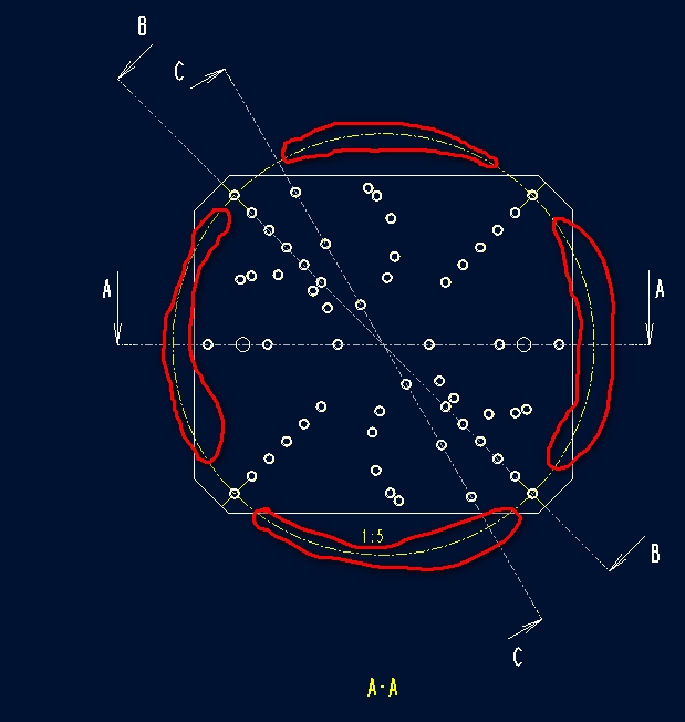

I would like to ask for help regarding breaking of a pitch circle. I need just to remove parts of the circle in red.1.jpg

Can you right click and make geometry first then, divide by divide icon command, then delete the unwanted section and make the circle construction again.

Thanx for so quick answer
the problem is that i cannot even select the desired pitch circle to make another steps....

Oh got it I guess your are working in drawing, I was thinking about sketcher. If you made it in sketcher I guess u must work on sketcher.

Just create a datum curve with the right color and linetype, put it on a special layer, and use that. You should be able to erase that circle.
