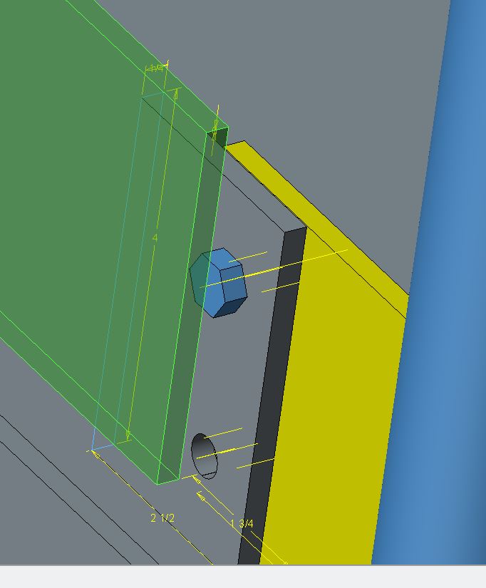

how to make model dimensions larger
this should be an easy one for all you guys out there.
How do I make these dimensions larger?

Doesn't the hidden config control this?
Found it - again. http://www.synthx.com/tom/sy_tip_0307.htm
TEXT_HEIGHT_FACTOR 40

David, that is not doing anything for me in Creo 2.0... at least not in session.
edit: I take it back... it takes affect after a while
SYNDAKIT15-MoonstoneAuthor
Jan 9, 2015 2:58 PM UTC
I can confirm that it does work. I'm using Creo 3.0 M020.
Although you can't search for it, you can enter it manually into the configuration options.
