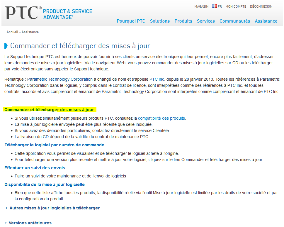

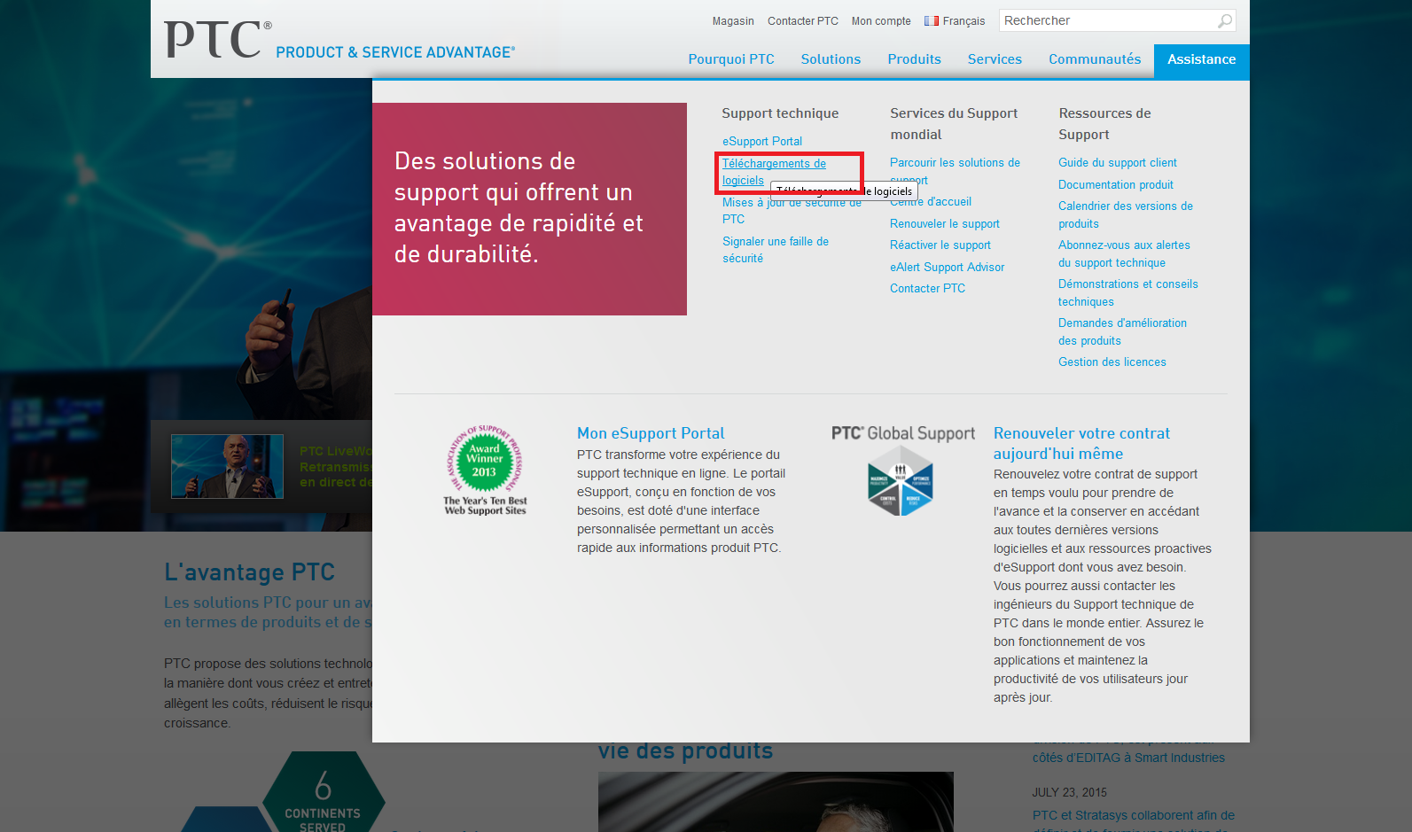

    You have to go on PTC website in the support part :
    Then you get on a new page where you can download updates :
    Everything is in french for me, but I suppose that in English it should look the same.
