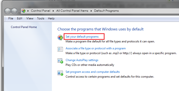

    That would be a Windows setting:
    You would have to set the default Windows mail program to Outlook. Pro E is reading it from the Windows default settings.
