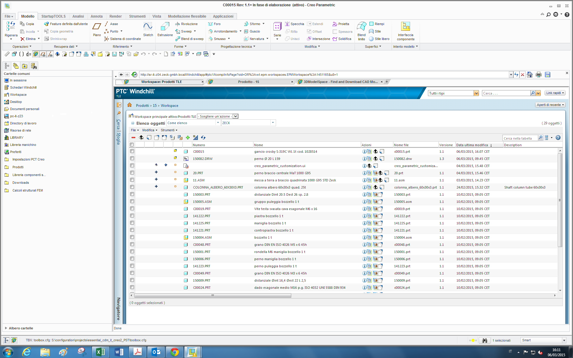

Hallo,
I am using Creo Parametric 2.0 integrated with Windchill, is it possible to set specific tabs to load automatically at the start-up of the program?
In my case, for example, one tab for the workspace, one for the common space, and one last for the 3D model space.
Just like the following screenshot:
thanks

    You can add one page (on one tab), but as far as I know that is it. Use the config.pro option "web_browser_homepage".
    We have ours set to go to the user's homepage: web_browser_homepage http://<server name>/Windchill/app/#ptc1/homepage
    There are a few other config.pro options to control the other tabs:
    enable_3dmodelspace_browser_tab yes/no
    enable_partcommunity_tab yes/no
    enable_resource_browser_tab yes/no
