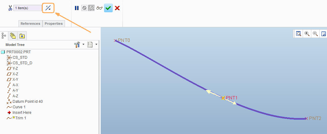

    you can 'trim' curves in the 'Editing' menu.
    You can use various elements as trimming references, such as points, datum planes, etc.
    In case you want to keep both sides, you need to toggle the direction twice (third time brings you back to the first direction).trim3.jpg

    Oct 19, 2015 12:03 PM UTC
    that is exactly what I describe in the last picture: if you toggle the direction twice and get the double arrow, the curve is split, you keep both sides that afterwards you can select as separate entities.
