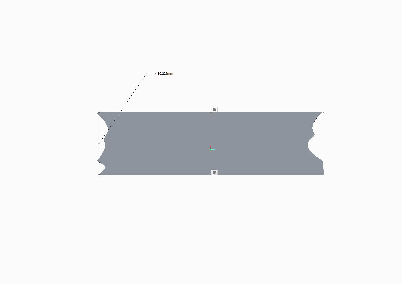

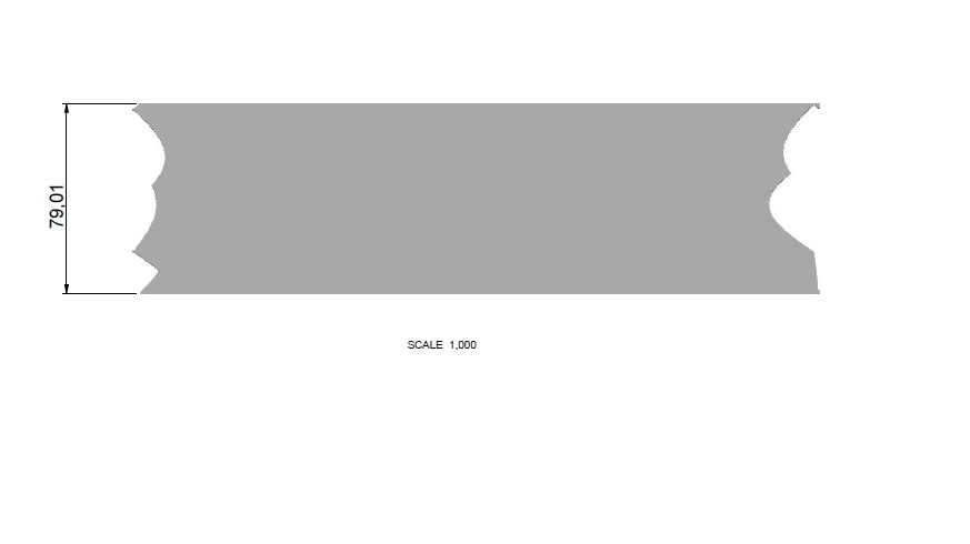

    schopra-21-VisitorAuthor
    Jul 11, 2014 6:22 AM UTC
    sir i have unfolded the tube but now what problem i am facing is in the sheetmetal the opened tubed width is 80.225 mm but when i take it to drawing its width becomes 79.1 its creating a problem in wrapping this profile around the pipe for notching. sheetmetalmeasure.jpgsheetmetal+drawing.jpg
    Jul 11, 2014 6:55 AM UTC
    It appears that the y-factor is being applied twice.
