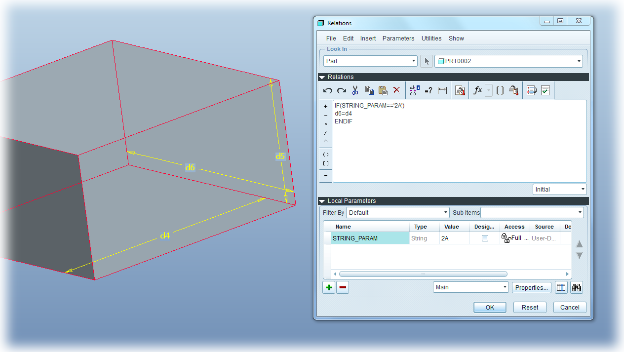

Hi all,
i have been trying to figure out how to write a relation, but without success. I have a parameter P1 which has a string value of 2A. I am trying to make the diameter of a cylinder = 102mm if P1 = 2A, so how do i write this? I tried the following but it did not work
IF(P1==2A)
d233=102
ENDIF
I guess a string value cannot be used in a relation in this way.
Regards
John

    Hello John.
    In to relation you can write a parameter with string value - do you need add an apostrophe - in your case: '2A'
    For example:
    IF(STRING_PARAM=='2A')
    d6=d4
    ENDIF
    Note: you can not use P1 parameter - this parameter is reserved by system

    Mar 18, 2011 10:39 AM UTC
    Thank you Vladimir, that worked for me.
