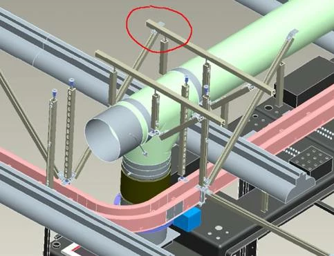

    I used piping to do preliminary layouts for ducting in a couple labs. Nice because it lets you easily adjust where the elbows and Tees are.
    After I got the general layout I had to build my own elbows, Tees, and earthquake restraints.
