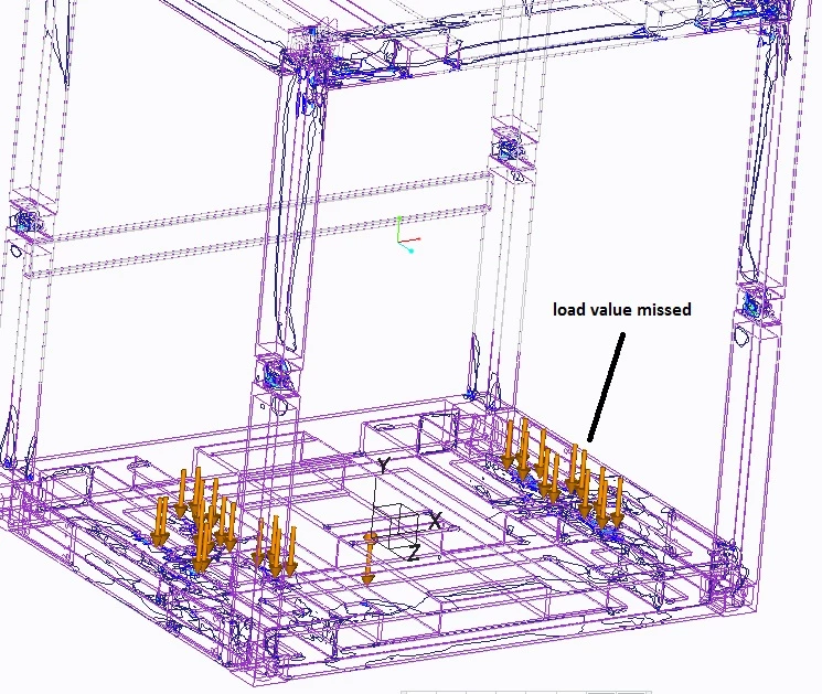

I ran 6 cases with differente loads, now, how do I know what was the load at 1st case?
Hello world,
Look, I ran an analisys where I had to evaluate with different loads. After a month I had to go back and verify the stresses and deflections, the problem is that I do not how to show the load value is for case 1.
for last case it is not a problem, I just check edit and I can see the numeric value, but for prevoius cases the only thing that I can see is the stresees, deflections and so on but the load applied for teh calculation,
see file attached
Does anyone knows how to get it?
I appreciate any help
thanks

    ‌If i remember correctly, each analysis has its own folder, and inside this folder there is a .prt or .asm file that you can open in Creo. Make sure to erase not-displayed parts before opening. This way you should be able to investigate the model.

    May 7, 2016 1:44 PM UTC
    Thanks Patrick,
    that is the right thing to do.
    I appreciatte the help
    Thanks again
