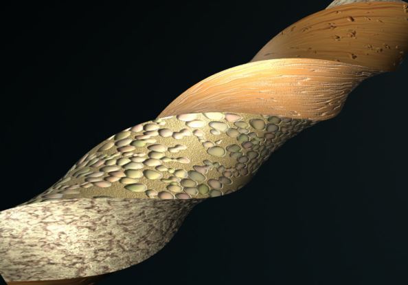

    That would be an appearance manager's Decal. A type of texture used by the render feature (colors with texture applied). I don't know if WF has this exactly the same, but you can apply an image to the color and then manipulate how it fits by editing the specific model appearance to scale it and orient it.texture_image.JPG
