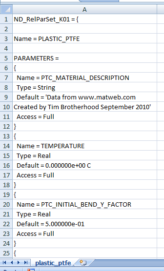

I have tried the way you suggest. I opened the .mtl file in excel to check the format for material properties arrangement. It will be quite difficult to arrange material properties as the same.
Is there any other way???
Attached herewith snapshots of format of .mtl file in excel.

Sajjan,
do not open Creo material definition file in Excel. mtl-file is a text file, you can edit it using Notepad++ or Wordpad.
