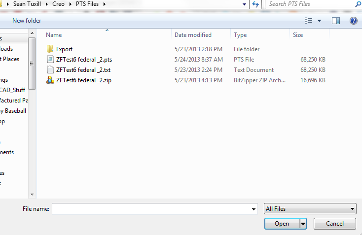

importing *.pts files into Creo 1.0
This seems like it should be fairly simple - go to "open" and bring in a *.pts file. But when I go to bring in a file, Creo doesn't even see the files, regardless of whether I tell it to look for all or just "*.pts". I've seen the actual physical data in the file and I can access it both in notepad and excel - in both cases, the coordinates are separated by spaces and not tabs. I've included sample data from the file and I'm not sure why I can't pull it into Creo. I'm also uncertain what that first line actually is (I think it's a count of the total number of points) and I'm wondering if just deleting that will solve my problem.

I've compressed and attached the entire file (it's currently a .txt), if anyone has any clue how to get this into Creo I'd be very appreciative.

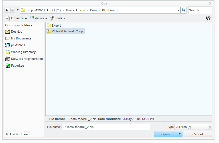

Oh, and Creo reports the point limit at 30117 for the import.

That makes sense...unfortunately, my software isn't seeing either of the *.pts or *.txt files, and I'm at a loss as to why.

Remove the spaces from your file names.
Yep, you do have to format the data. Bring it into Excel and create the PTS file from there.
