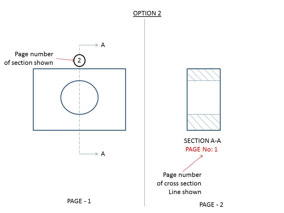

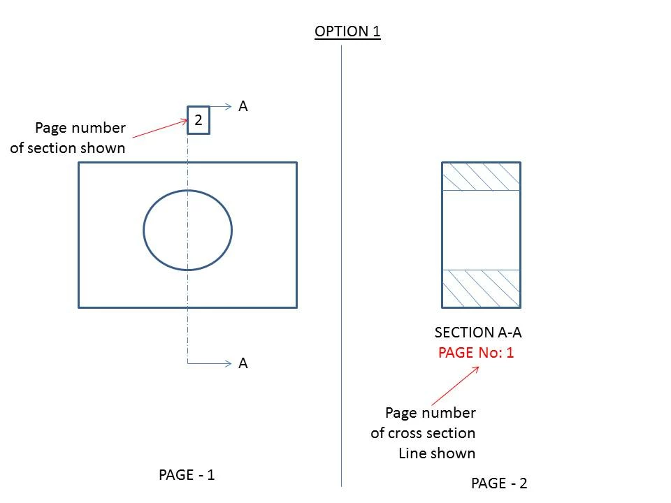

hai all....,
how to indicate page number in cross section line and cross section view by manual or auto as shown in the pic below or any other possible way.

    Are you ASKING how you would do this parametrically? If so, to my knowledge, you can't do it easily. That would be a really nice enhancement to drawing mode.

    I don't know if this is a standard convention according to ISO, JIS or ANSI. It is a good idea but I suspect you will have to do this manually for some time to come.

    I believe there was a way of doing this by splitting your drawing sheets into zones, but it was such a pain and the fact that the zones didn't match what the drawing format zones meant that nobody uses it.
    That would be a GREAT and long-overdue upgrade.
