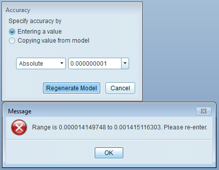

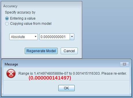

    Aug 16, 2013 4:04 PM UTC
    No, accuracy_lower_bound definitely affects absolute accuracy. Try it. Open a part and try to set the absolute accuracy extremely small. A box will pop up telling you what the minimum allowed amount is. Cancel out and change the accuracy_lower_bound to .000001. Now go back and try to set the part to the same very small accuracy attempted earlier. Assuming your value is small enough, you will once again get the pop up telling you what the minimum value is, but it will be MUCH lower than before.
    accuracy_lower_bound not set
    accuracy_lower_bound 0.000001
