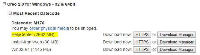

How do I install the Creo 2.0 help files locally on my users' computers.  Where do I find them?  Are they a separate install?  Thanks!
    TomU
    Aug 19, 2015 7:53 PM UTC
    Yes, help files are a separate installation.  You will need to either download them, or install from CD (if you have one).
