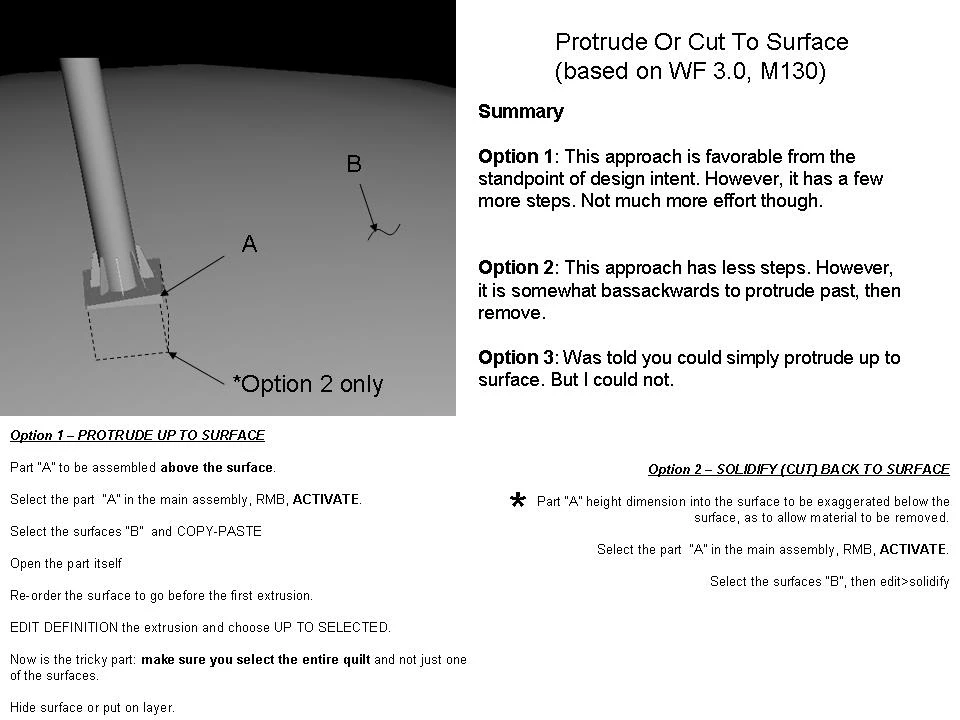

Intersect/Cut - S U M M A R Y
All, 3 options. 2 work for me. Please see attached. Wayne
    wfalco16-PearlAuthor
    June 4, 2009
    Here is option 4, supplied by Ron Thellen. This one seems like the BEST one. Thanks Ron for really working with me on this!!!!
