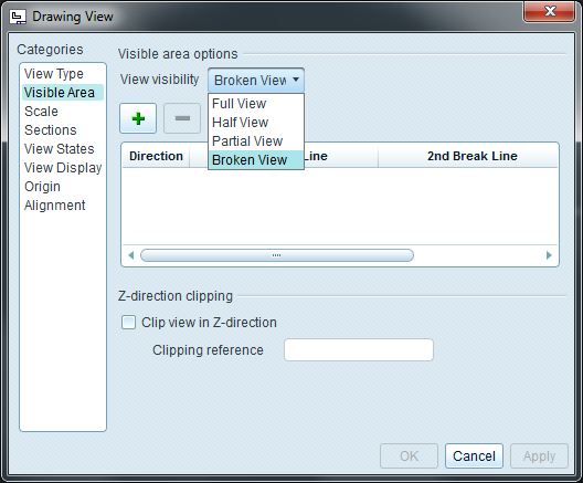

Is there a way in PRO/E to make a Partial and Broken View at the same time?
I have been useing Pro/E for about 13 years, and have never had to do anything like this until today.
Is it possible to created a partial and broken view at the same time?
I am using Wildfire 4.

    Zhump1-VisitorAuthor
    Nov 15, 2010 1:36 PM UTC
    Yes I know how to do this, but can you make both a Partial and a Broken View in the same view?
    I'm not sure it is even possible, other than making multiple partial views and aligning them.

    Hi
    I do not think so. Maybe you can solve it with multiple breaklines.
    Even in WF5 you can have your problem.
    Regards
