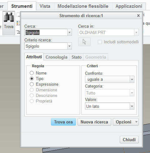

Aug 7, 2015 9:24 AM UTC
I often have same trouble. Best way for me is finding edge which have one side (they're connected with one surface).Cattura.PNG
