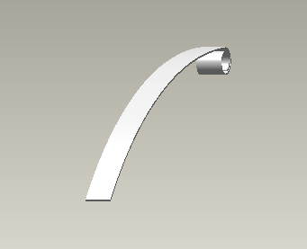

    Are you looking for something like this Greg?

    OK, here's what I want to do. In assembly, I have a rectangular flat spring steel fixed at one end. On the opposite end I push on it with a plunger (cylinder) to bend the spring steel into an arc. THe act of the plunger moves the spring steel. How do I make the spring steel flexible at a known length at the fixed end.

    September 8, 2010
    Greg
    There is a fairly simple way of creating such a part; I have used this successfully in the past. If you sketch a short straight line for your fixed portion, then a 2-point spline tangent to the line and bending away from it for your flexible section, you can extrude and thicken this sketch to create a part like what you want. There are complicated ways you might control the length dimension of the flexible portion, but if you just create a construction circle through the end point and set its radius you will probably be close enough. Now to see your spring in the unbent condition, just change the "bend-away" dimension to zero. You can also use 3 or 4 point splines, arcs and conic sections to create similar geometry. In an assembly you can use various techniques available to make it "work"; perhaps the simplest is to create an assembly Relation that governs the flexible part dimension.
