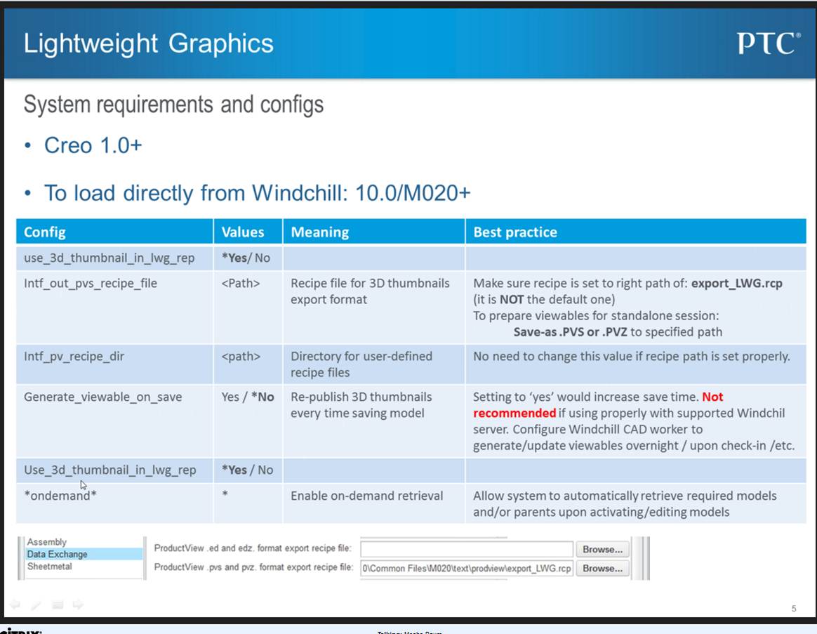

    Do you have the settings outlined in this image?

    Bill,
    I appreciate the image, but those settings are only if you are to publish locally to your hard drive. We are using Creo 2 M050 and PDMLink 10.1 M040 with a couple CADWorkers that automatically publish on Check-In.
    I can get it to create the .pvt using the settings that you specify above, but not tied to a CADWorker. There is a PTC Document that specifies settings that I have walked thru with numerous PTC Tech Support and we still cannot get it to work correctly.
