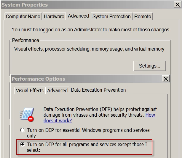

Can CREO 2 be installed in a folder of my own choosing on a different drive (e.g. D)?
Barry Schaeffer
Fluke
    July 24, 2013

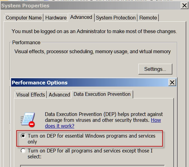

    Yes that can be done, sometimes Windows 7 gets in the way of letting you do that if the drive is a network drive. Or if the install script is on a network drive.
    If the install script is on a network drive:
